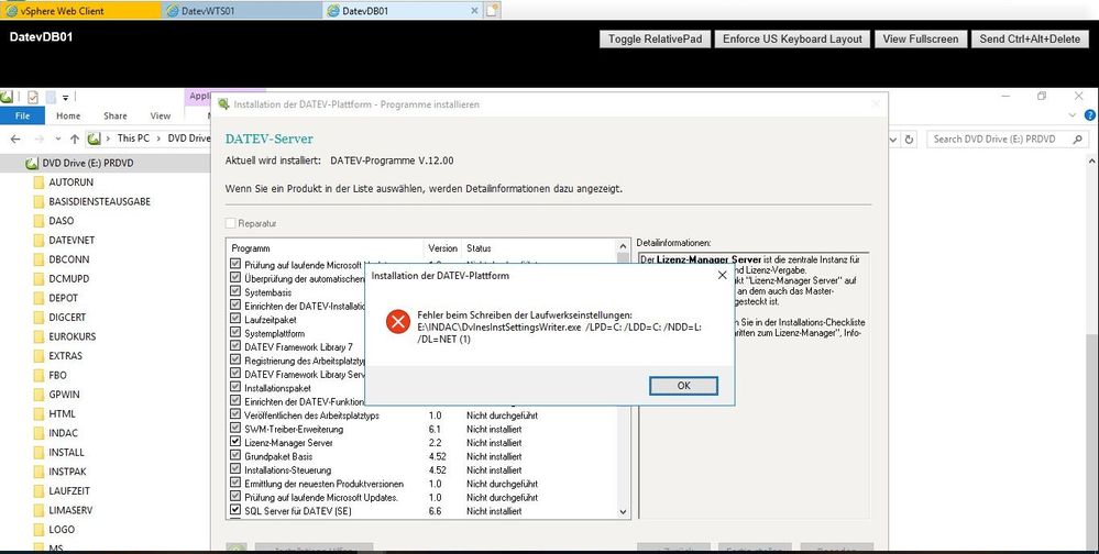

I have a virtual server with Windows Server 2016 Standard (updated to 14393.2515) and SQL Server 2014 (updated to SP2+CU13 - 12.0.5590.1). Server is DC also. Datev DVDs is connected as ISO. Installation was made through "Run as administrator" and using local admin's account. During installation I got an error:
427 Mal angesehen
Hi,
you already checked the userrights of L: (\\windvsw1 as shown in the installationguide)?
Perhaps this is part of this fault?
norther73
427 Mal angesehen
Yeah...I checked the rights twice - all are correct

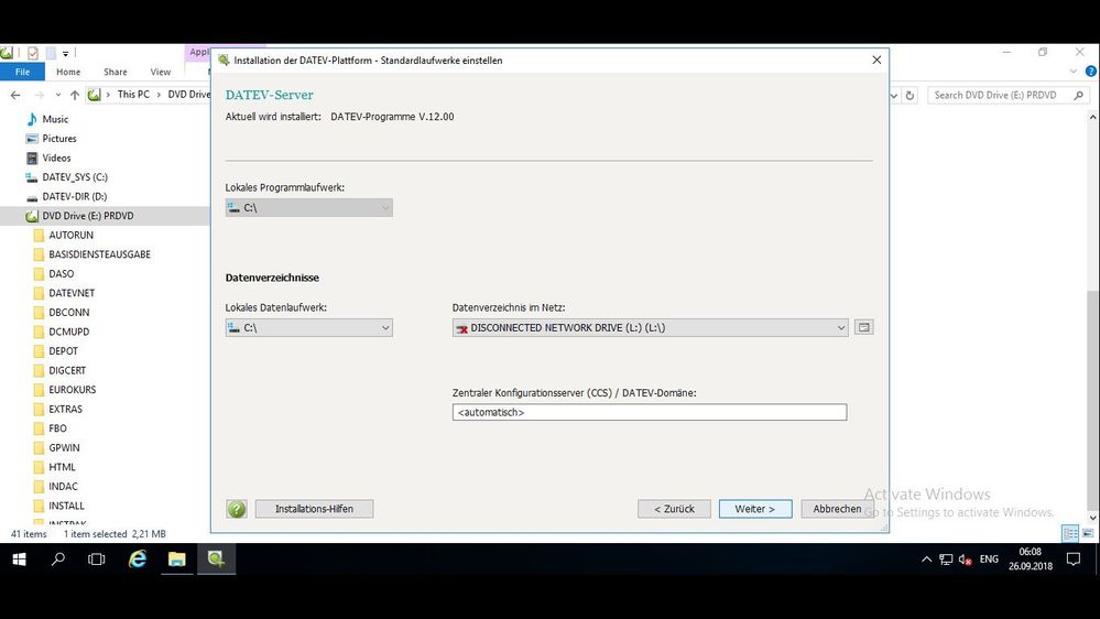

can the above error be a result of disconnected network drive (L:)
426 Mal angesehen
Yes, that's possible or the solution. If you install the DVD 12.0, networkdrive L: has to be mandatory connected. Otherwise, the installer can't write data into L:\DATEV\DATEN and the CONFIGDB.

Other words the installer reads network drive status only without "real" access test...
OK...will check it tonight...
tnx alot
norther73
427 Mal angesehen
Yeap...this is it
When network drive status become "connected"/green (drive connects through GPO's User Configuration), Datev-Platform installation performed like a piece of cake
